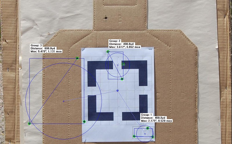

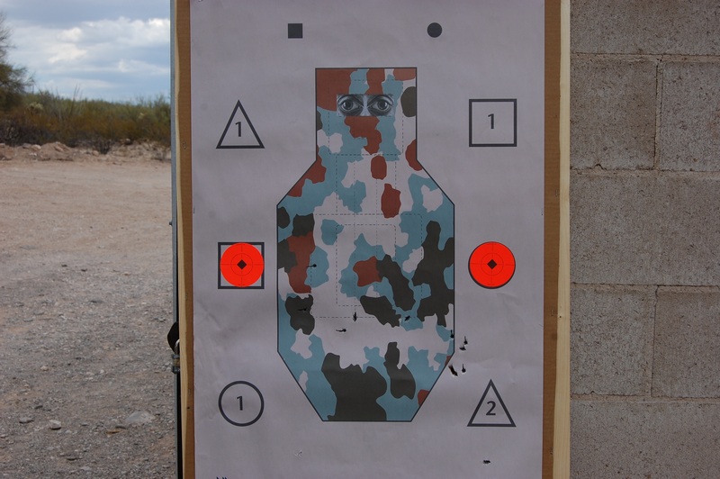

Had this out after the VSF:
Basic drill for this session is to get a zero, evaluate the ballistics and adjust the 'zero' elevation if needed:
After bore sighting I shot the initial zero with HSM 168(cost less than Fed168). Confirmed the zero POI w/ 5rds of Fed168. I then shot a group at longer range, not shown on tgt, and the POI was about 2moa low.
Following day; I added two moa and shot the 600(this confirmed the 2moa adjustment as correct), 800, 400 and two rds at 100 to get POI data. POA for 6, 8 and 4 is center diamond.
This is a stock rifle, well, it was when this was shot. It has since had the trigger reduced to 4# from the previous 6#. It is probably my favorite rifle in .308, the size is handy and it is accurate right from the box.
DK had an LTR a few years ago, it was a 1moa gun with me behind it. I really like the size, but would have liked it more if it was sub moa...
Nice looking bang-stick!
4# trigger is crazy talk, 2.5# is where it's at brother... ;)
Yes, it is almost always a factor here.
I think most of that session I was holding for about 5mph full value at the 4, 6 and 8 yard line.
I make a wind call based on visual cues and what I see through the scope, then send the shots at as rapid a rate as I accurately can. At times I will put a shot in the berm to get a better wind call. I am after groups on tgt and not concerned w/ bulls eyes. Vertical POI in relation to POA is what I'm mostly looking at.

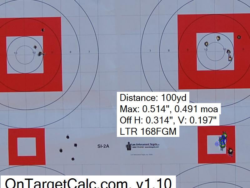

...but would have liked it more if it was sub moa...
This one is easily sub moa w/ Fed168.
I did shoot a custom that was built using the old M40a1 stock this week. It had a 2.5# trigger on it. I will do a short review of it in another thread.
My old LTR was sub-moa as well with FGMM 168's

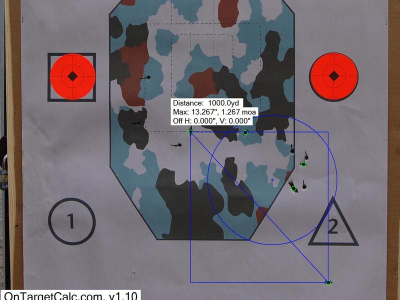

Remington LTR, RR800-2, 1000yds w/ Fed GM 168:
Confirmed zero this AM. CB and three shot group:
This afternoon:

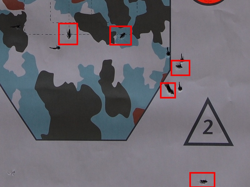

Other impacts(marked w/ black line) were two groups from the 600yd line. Boxed in red is from 1000.

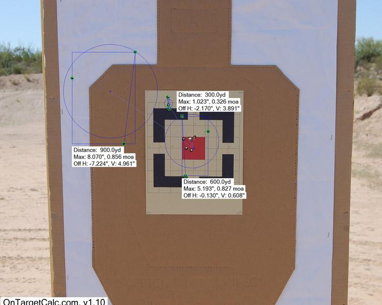

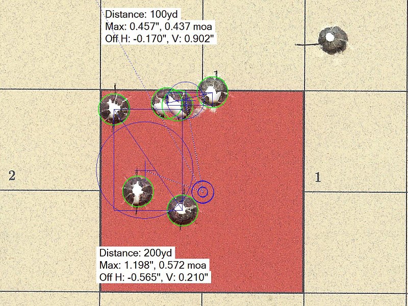

Two more days w/ the LTR, checking some data on a reticle
Remington LTR w/ bipod, Fed GM168, conditions for both days was about 108F(shade) and 10%H @ 2600ft. Winds were variable in direction and velocity but never need more than a 10mph hold.
Yesterday:
I had zeroed the rifle and scope earlier at 100yds(POA=POI@100yds), shot 400 and added 1.5moa elevation and shot the 400 again. Then I shot the 800.
Today:
Started at 900 and then shot the 200, 300, 600 and finished with a final group at 100yds.
200 and 100yds:

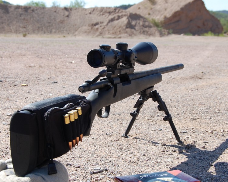

Remigton LTR:
