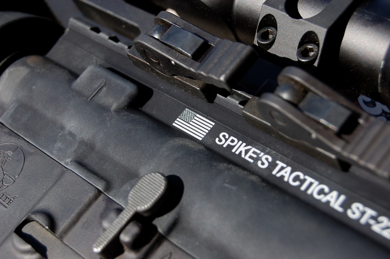

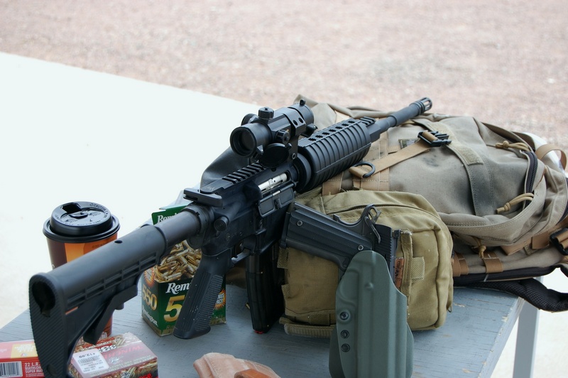

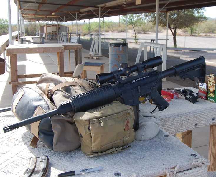

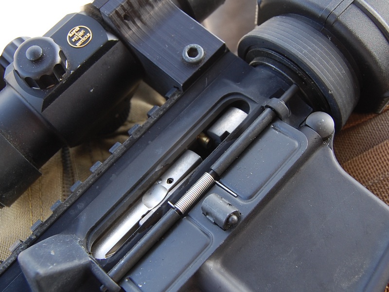

Found this on the doorstep when I got home from the range. Loaded it up and went back. Only shot about 80rds through it. Might of been enough to get the initial rough feeding and extracting out of the way.
I will take it out in the AM and put a scope on it, just to see how accurate it is, then either a 1-4x or red dot.

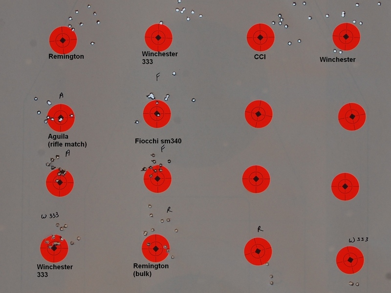

Bit windy for shooting a .22 at 50yds today. Scope was already on so gave it a run with several brands of ammo.
Tgt @50 yds., 1.5" pasties. Groups improved towards the end(except the Remington), maybe I was getting used to the pounding recoil....
Two three shot groups at the bottom right were w/ the red dot at 25yds. The Winchester 333 will be the main ammunition I try and stock up on, best 'bang for the buck'. The Remington sucked. Probably ran about a 30% malfunction rate. Majority were failure to fire, the firing pin does not get a long bite into the rim and result in the failure to fire. None of the other brands seemed to have this problem.

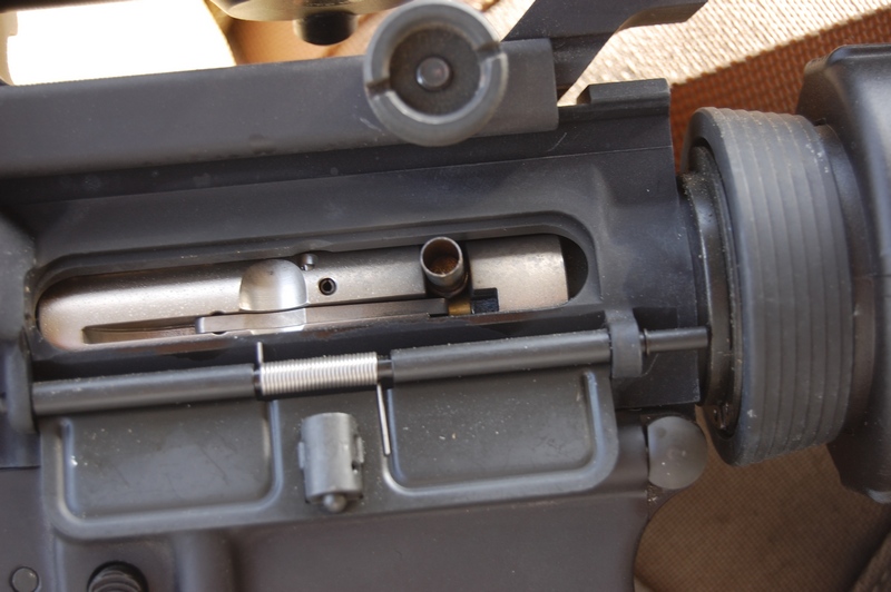

Had one of these:
and a few of these:
I started out with the weapon fairly 'dry', per directions. Added a bit of oil after a few hundred rounds and the reliability improved.

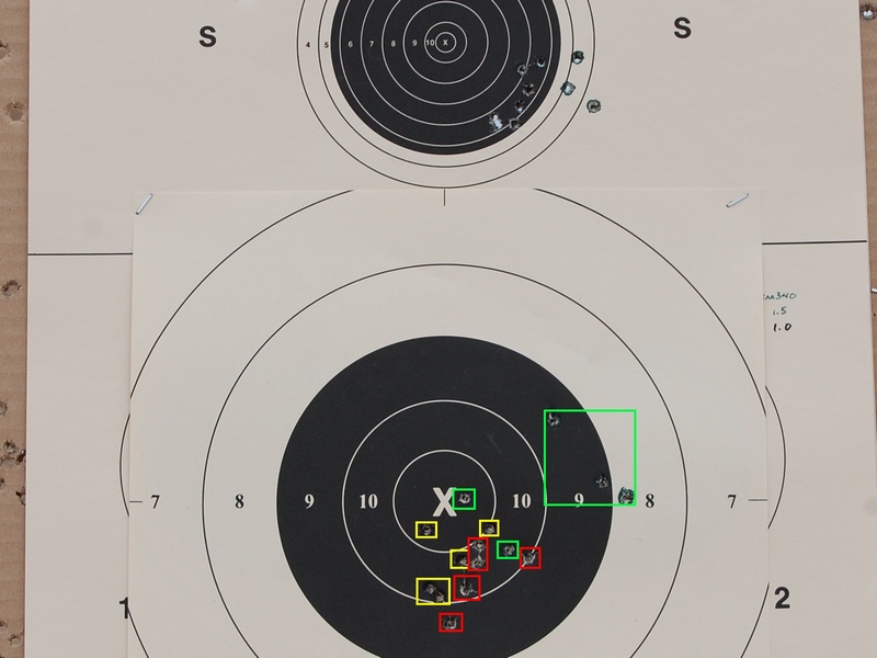

Left the red dot on the upper and shot some five shot groups at 50yds, benched, pack, no rear rest:
Top: CCI Green Tag, 1.35", .85"
Left: Wolf Target, 1.45", 1.55"
Right: Fiocchi sm340, 1.5", 1.0"
Left: Winchester. 333, 2.76", 1.5"
Right: Remington, 1.64", 3.5"
A person could probably get sub 1" consistently w/ the match ammo if using a scope and a solid bench/prone position.

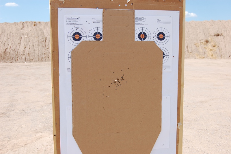

I did a five shot string from; offhand(green), kneeling(yellow) and prone. CCI Green Tag @ 50yds:

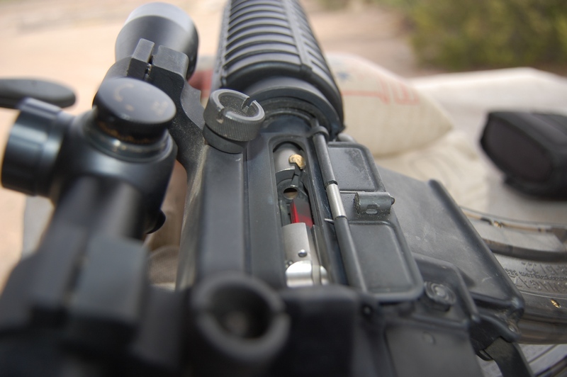

The Remington bulk ammo is nothing but a pain in the ass, multiple failures(fire, chamber, extract) about 100rds fired. The Winchester had one failure(stovepipe) out of about 100rds fired. The other ammunition was failure free, about 50rds of match ammo.

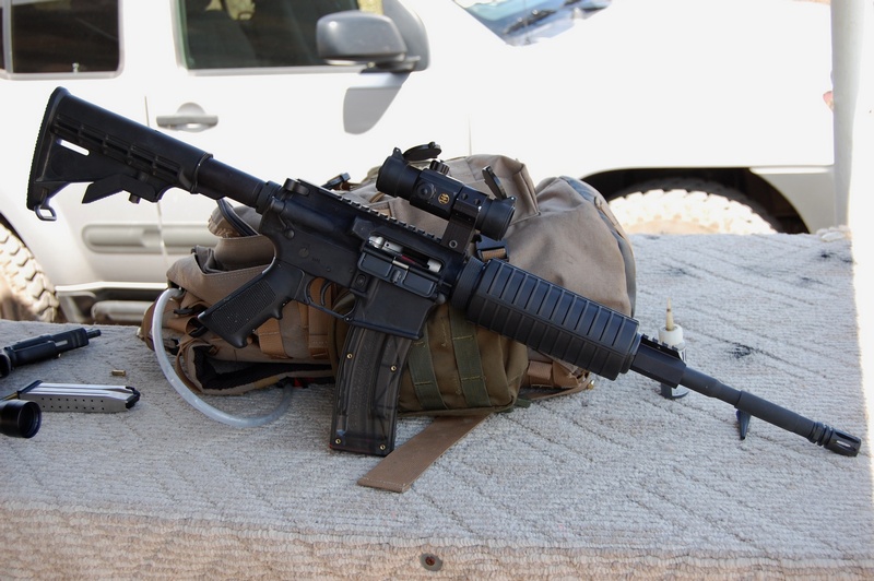

I like this Spike upper:
Works well for speed, transitions and accuracy drills.
Not good for malfunction drills and reloading drills.

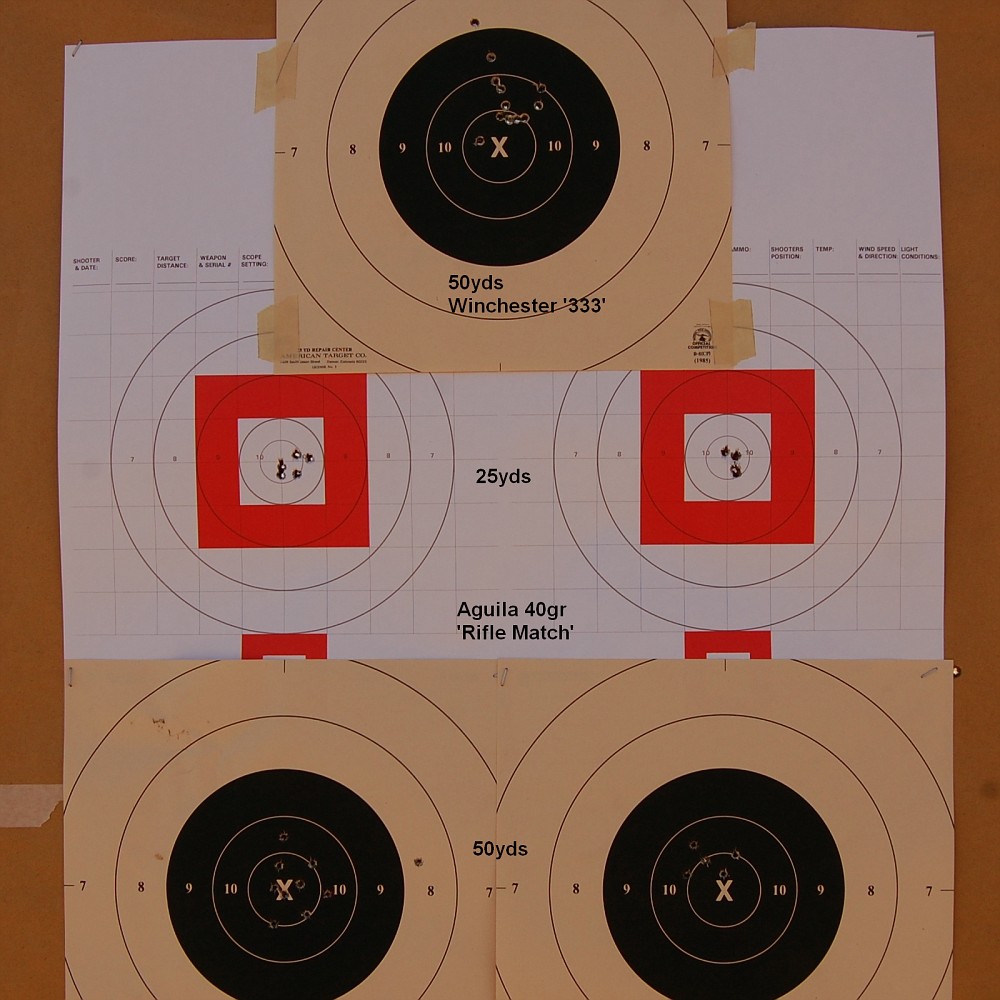

Today I wanted to give the Aguila another go. For "match" ammo I think it is the best deal going if you have a rifle that shoots it well.
The best group is .45" @ 50yds(bottom left tgt circle) w/ the red dot.

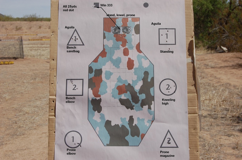

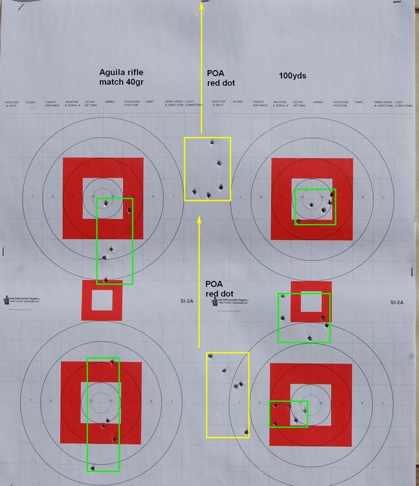

I wanted to give the 100yd line another go.
Aguila ammunition, sandbag and rear sock, scope 9x(outter row of tgts), red dot(center shots). The left tgts I shot a bit fast, trying to shoot during a lull in the wind, right side tgts I slowed down a little.
Mounted the red dot back on and did the two center groups at 100. The POI is about 8-10" below the POA w/ a 25yd zero.
Did some position shooting w/ time. Nothing fancy, just shoot five rounds off of one normal breath of air:
I confirmed the POA/POI for the Win 333 and then did a position transition drill; standing, kneeling, prone, 5rds ea.
I tried the Fiocchi sm340 again. Maybe the rifle was a bit dirty, blew the rim off and I had to scrape the brass out of the chamber....cleaned it after this incident:

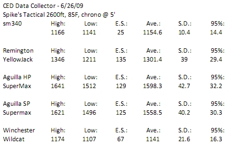

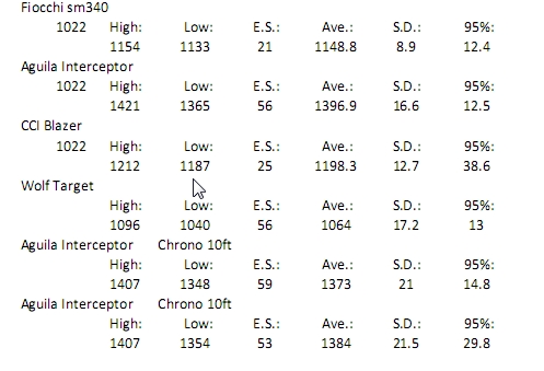

Shot w/ the Spike's Tactical ST22, 10 shot strings @ 5ft from the muzzle. 2600ft and 80F
The first four strings were shot through the 10/22 w/ 18" barrel(ST22 has a 16" barrel).
Last two strings were w/ the ST22 and 10ft from the muzzle.

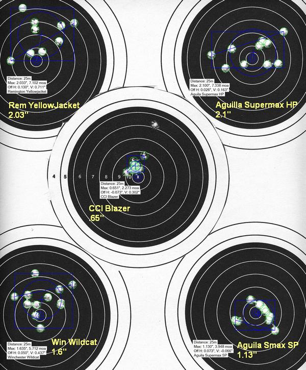

ST22, 25m, red dot, pack/rest.
Blazer fired off a double, that is the high flyer way out of the group, did not count it. Blazer has been the standout for accuracy/price and very reliable....well, other than the occasional 2fer1.
Shot the sm340 as a 'baseline' and to see that the chrono was ok. Most consistent ammo, for velocity, very accurate in the 10/22.
Yellow Jacket has a 33gr HP, two Aguilla loads have a 30gr bullets, Win 40gr solid, sm340 40gr solid.

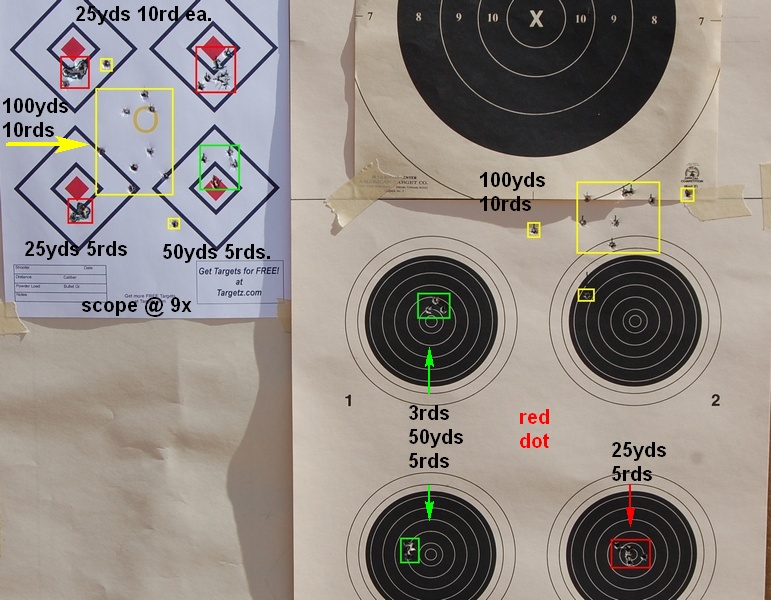

*POA/POI verification/confirmation done on 6/27*

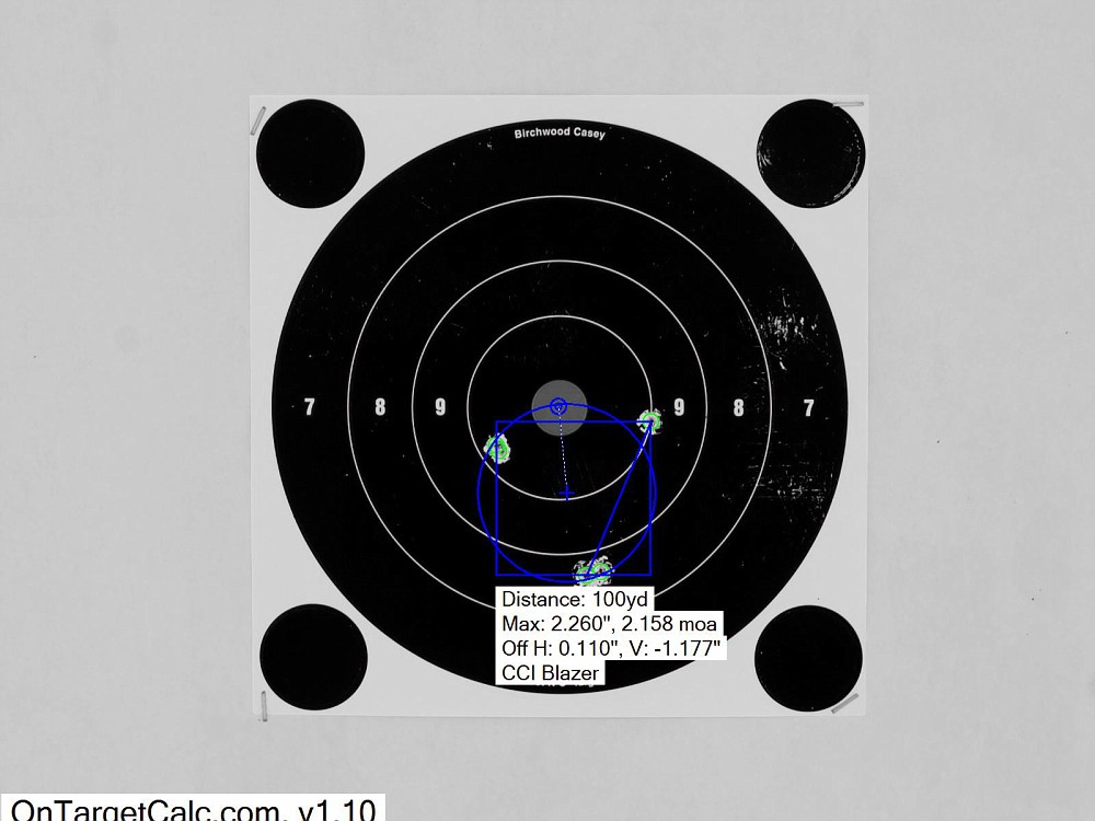

I started by confirming my POI at 100yds w/ the ST22 and CCI Blazer ammo:
I did the same w/ the AR and zeroed it about 1" high...no pic *curse the gods*
Did a quick check on POA w/ POI at various distances to see the variation between the two. Left side was shot w/ the Spike's Tactical and the right with my Armalite M-15A4C, both using a red dot sight. Three shot strings except at the 100.
Everything seems to jive fairly well, the 50 is the biggest difference with the ST22 impacting about 3" high vs the M-15A4C. Shooting at center mass body though, it will not be enough of a variation to require a different aiming point.

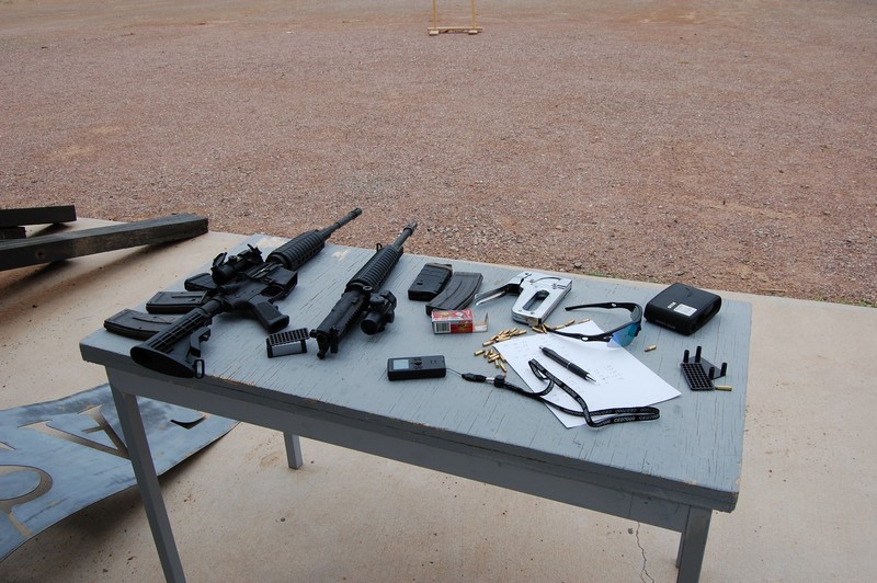

*July 14th*
I was going to do this as a video but, umm... the battery went dead, so-

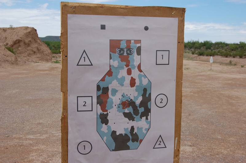

Just did a series of two shot drills on the timer, I was looking for the variation in splits between the .22lr ammo and 5.56 55gr ammo.
I did a series at 11yds and then repeated it at 5yds. Both carbines are basically stock.
Exercise: from the low ready, index the target and fire two shots, record the time split of the two shots. Repeat.
11yds w/ .22lr:
.18, .19, .18, .18, .19
11yds w/ 5.56:
.20, .19, .19, .20, .20
5yds w/ .22lr:
.15, .15, .16, .16, .15
5yds w/ 5.56:
.16, .16, .15, .17, .17
One shot is out of the 'A' zone, center left, it was one of the shots w/ the 5.56 at 11yds.

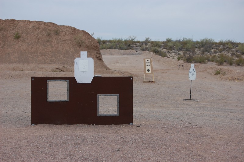

I did another run today. This time it was two targets, one at 10yds and one at 50yds. Shoot the 10yd target three times and the 50yd target once. I did this five times with each rig.
The splits for the 10yd target averaged(3 shots per string, five strings) .175 for the M15a4 and .17 for the ST22. I was pushing hard w/ the AR and you can see(maybe not, vid sucks) the 'groups' open up as a result.
The split for the last shot, that is the transition from close to far target, averaged over the five strings, was 1.39 seconds w/ the M15a4 and 1.45 seconds w/ the ST22.

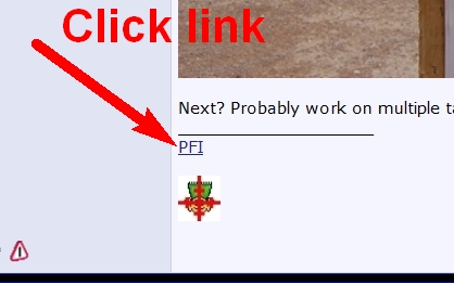

Next? Probably work on multiple targets and ... uh...my video skillz.

So who is PFI? I googled it and came up with a tone on companies! But I assume you don't working for the Plumbing outfit!!!
