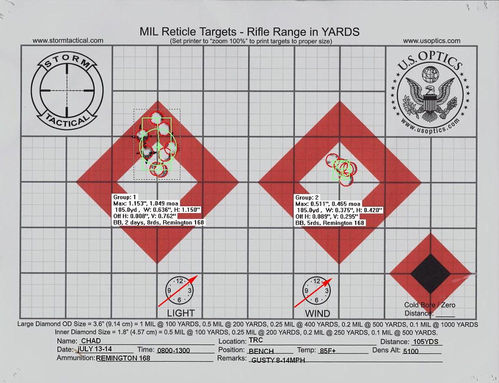

Day one and two-
Did the barrel break in: fire one, clean repeat 10x(left group of 8rds, first two off paper)
Then started the 5rd groups w/ cleaning after each, Remington 168(right group)

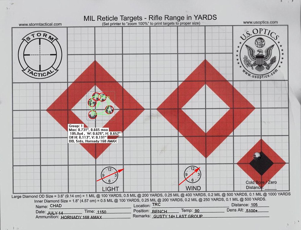

Hornady 168 AMAX

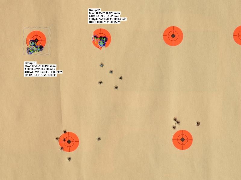

Day three
200yds, cleaning between each 5rd group:
Now that the barrel breakin in is done I will start cycling through about six different factory match loads and see how they print. Then I will pick one,
zero the scope and shoot some distance.

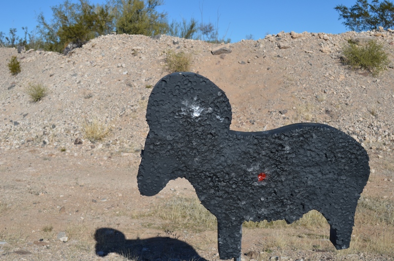

Confirming elevation at 550yds, 3.8mil, 3rds clustered on top of each other, POA center of the horns, DA 1100, 35F, 27.58inHG, 45%H, prone w/ pack/bag.
Yes. Difficult for me to shoot the rifle that well consistantly. I expect to shoot around .5moa off of a bipod w/ rear field bag with ammo that shoots well in the rifle. I think it has shot every type of match ammunition I have tried under MOA.
