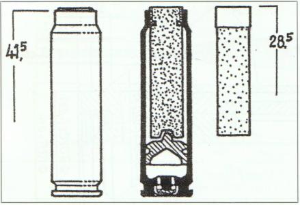

No-BS from what I know. It should work on different cartridge design, where expanded gas is kept inside cartridge. Will try to find pics somewhere....
Found here: http://www.cruffler.com/Features/NOV-01/trivia-November01.html
7.62x42 blowback, double-action, external hammer, 6-rnd box mag. The cartridge has a piston between bullet and propellant. The propellant explodes, drives the piston forward to impell the bullet; the piston is arrested by the cartridge shoulder. The noise is retained inside the cartridge case.
Effective range is about 50 meters.

Typical variation of the old "spigot-launcher" type round. Research the PIAT and the spigot mortar and the "Hedge Hog" launcher.
"How does the case retain the gasses without building preasure and blowing up the gun?"
Look at the listed muzzle velocities.
High peak impulse of short duration. Sustained peak pressures are what blow cases.
A short, sharp shot to accelerate the projectile. Also the steel cases are re-inforced at high stress areas.
