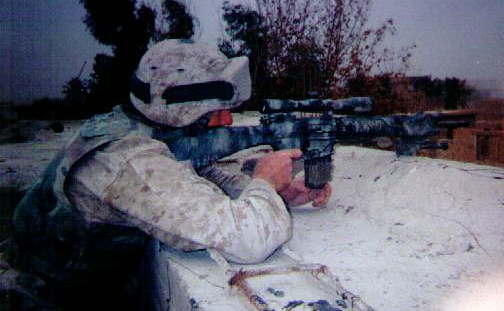

SR-25 w/Leupold Mark4, PVS 22 night vision, ans sound suppressor
Positives:
The SR-25 is the most ideal precision rifle I have ever used in combat. It is more tactical and employable than any bolt gun I have carried. The fastest bolt handler in the world could not keep up with the semi auto. The gun is lighter, shorter, and easier to maneuver. I engaged targets with out to 750 yards with it. In the urban environment most shots were 100 yards and in so the semi auto was superior for follow up shots. Snipers that would work with infantry units should expect some grunt type work. This is especially true when grunts get injured and start getting low on personnell. I used the SR-25 many times to clear buildings and other tight spaces. The quad fore end rail was helpful in mounting the PEQ 2. Then I could "flood" my own targets. Most Iraqi houses have a 4 foot wall on their roofs. A lot of the shots were taken from the standing position with the fore end of the rifle resting on the ledge. The mag well allowed me to push the rifle against the wall and lean into it for sturdiness. It was considerably a better position than with an M40A3. A lot of the shots taken were at running targets and targets that only showed themselves for a few seconds. The SR-25 was a lot faster in any multiple engagements. The recoil is less and target acquisition is easier when you don't have to operate the bolt. Any normal Iraqi could not tell the difference between the 25 and the M16 service rifle.
Negatives:
The 25 is not as accurate as the A3. I shot 1 1/2 - 2 inch groups at 100 yards. The 25's barrel is shorter and therefore velocity is less. It must be kept clean and well lubed. It had no forward assist. Some of the carbon blowback would go down into the mag. The bottom rounds in the mag were black with carbon. The semi auto action would sometimes scrape the bullet when it entered the chamber. I never tested the drop in accuracy from this but it could not help. The sound suppressor worked well but was too heavy to have on when patrolling. It made the gun very front heavy. The suppressor fit over the end of the barrel and cause pitting on the barrel. Anytime I shot with the suppressor on I had to clean the barrel ruthlessly.
